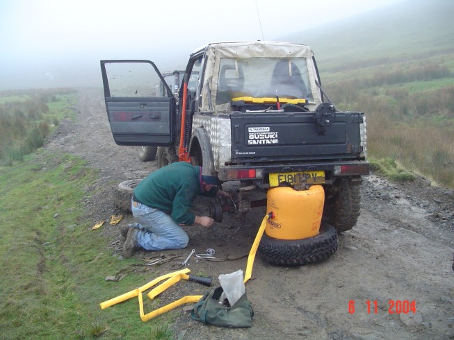

I have a Draper airbag jack, and as long as you have a "conventional" exhaust i.e. round tube, not flat, then you should be ok to use it. It comes with a groundmat, to help on stoney gorund I guess.
I didnt have much success with it on muddy ground TBH but it worked well on my Suzuki here....(I broke the rear axle u bolts here) so I used my spare wheel to act as a placemat, you will notice that I also had a hi-lift supporting the Zook.
