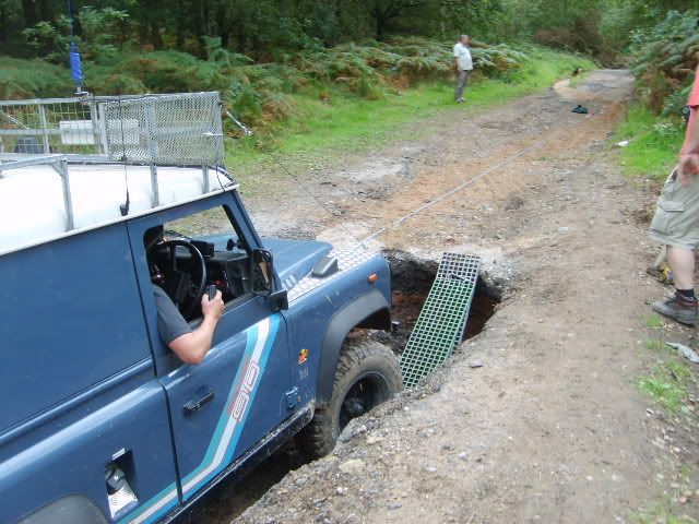

PostSubject: Re: Champion winches + Other winches   Wed Jan 12, 2011 8:20 pm
first rule of winching, the operator keep an eye on the winch.
http://gs136.photobucket.com/groups/q176/P3MU9QIL52/
